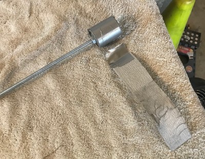

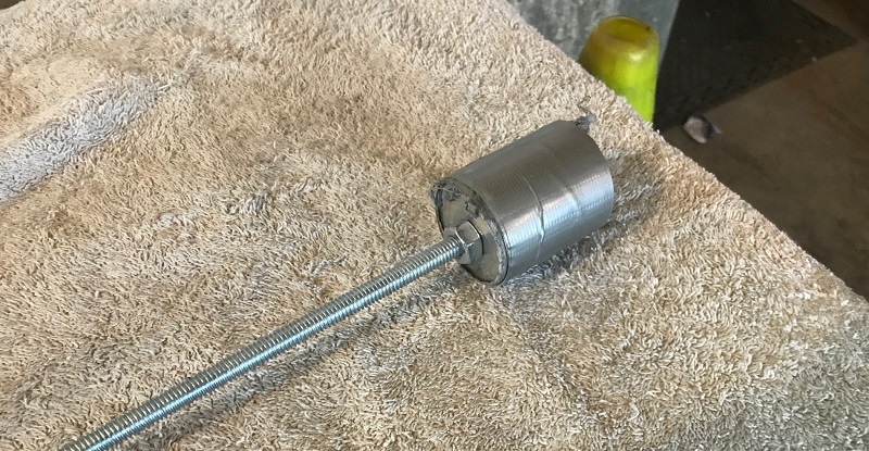

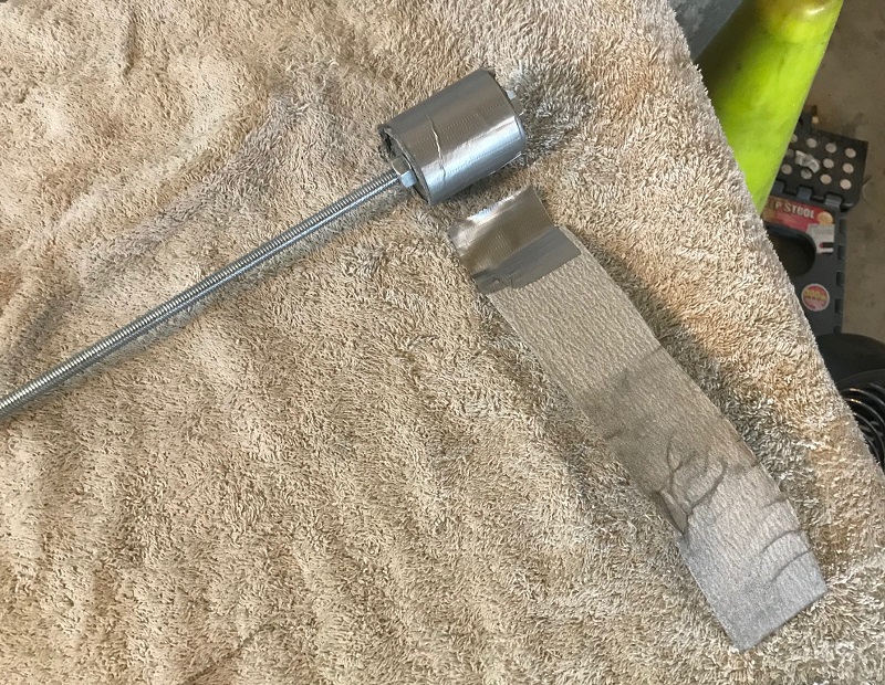

Anyway, I thought I'd share my solution in case you need to hone a barrel ID. I used a threaded rod with two nuts and two large washers. I wrapped duct tape around the end of the rod and then taped sand paper on it. I used the nuts and washers to sandwich it all together firmly. As the barrel ID gets slightly larger, add an additional layer of tape to increase the diameter then put more sand paper on it.
Cut a strip of sand paper that's the same width as the duct tape and secure one end of the sand paper with a piece of duct tape, then wrap the sand paper strip around the duct tape until it wraps around at least one full wrap (make sure to wrap in the right direction so it doesn't unwind itself during honing). Use a hand drill to rotate the rod and start honing. Make sure to grind down a little flat spot on the rod so it doesn't rotate in the drill chuck. I used a 5/16-18 threaded rod and just rubbed the end on the cement floor to flatten it. It actually works really well. Not sure it would work with a PVC barrel though.
The blue tape at the bottom is a stopping point for the length of the barrel.
Honing a barrel ID - a quick how-to
