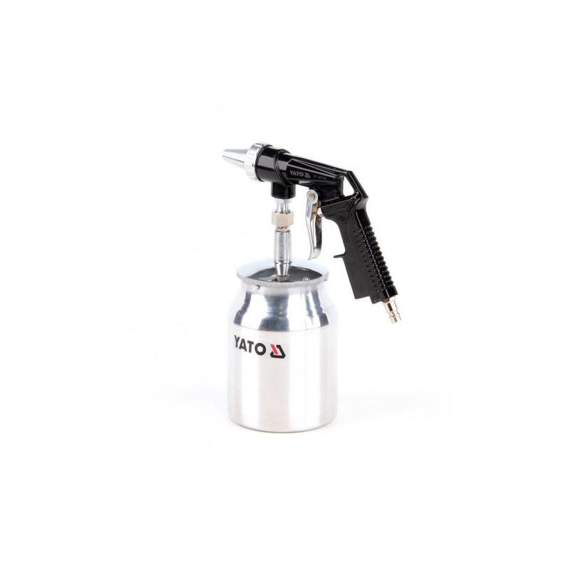

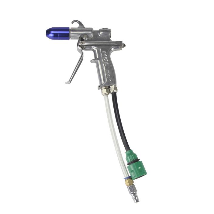

Can you send a photo what grease gun looks? something like this or this another?

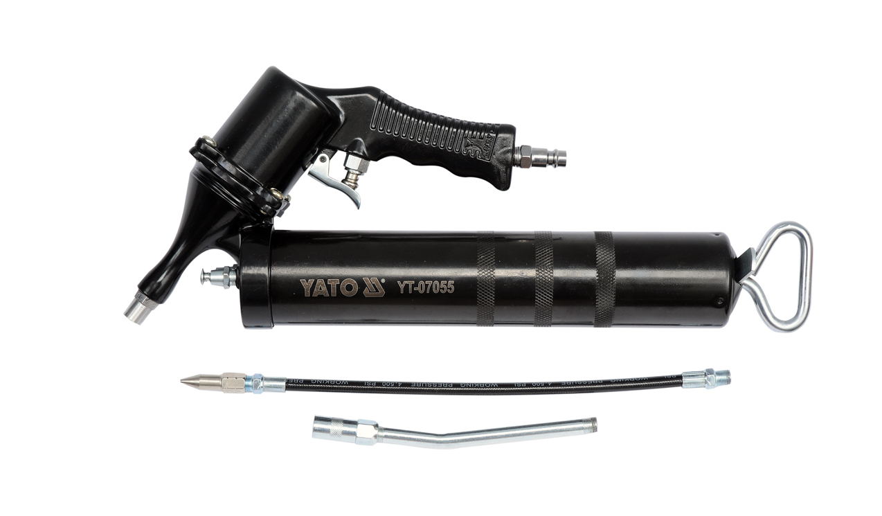

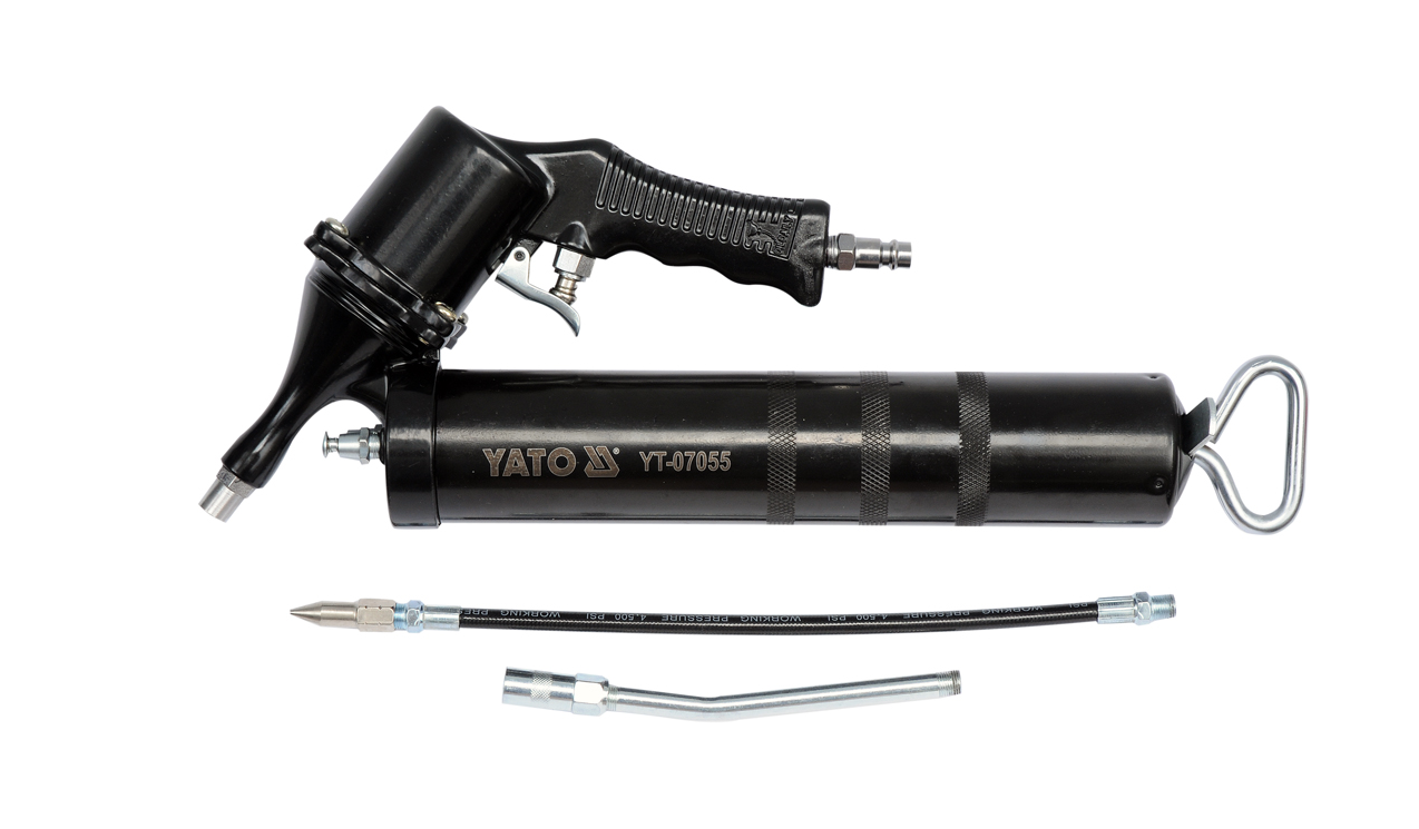

More like one of these, I'd have thought.

The "forced" question: With the necessary modifications, do you think you can pump air with that? :roll:

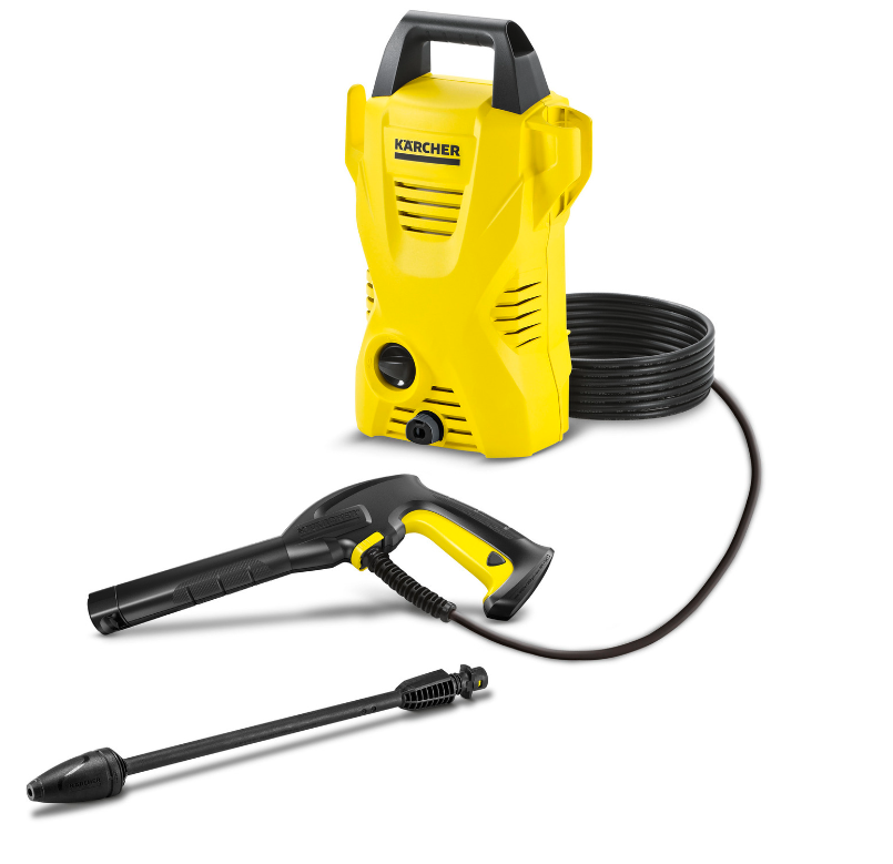

Ok . I have 0.8 liter HPA tank and i want to test 0.25 liter bottle to something around 500 psi. How can i do this? i have air hose with quick disconnects and i need to connect it to a valve that will be connected to tank with water? Something like this blowgun? or just normal kercher will do the trick?

If you have to ask... Yeah, go buy a grease gun and some honey.

Yea i think I will use Karcher 190 bar pressure washer and connect it to tank. ( but i want to test 0.2 liter tank and the pressure washer will fill it to 190 bar in second how can i stop that?) and have you any idea how to clear water of that tank to not get rusted? Thanks for the help.
