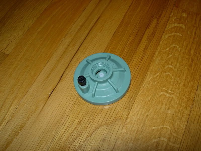

can i just screw the fitting into where the solinoid was here is a picture
Benny
Posts: 844
Fill the hole w/ epoxy and tap to the side..... or, fill the little exaust hole that goes out from that little solinoid port then put a nipple strait in there.

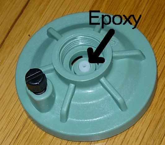

so you mean something like this, just fill in the little hole?

You can't use an unmodded sprinkler most of the time, it just honks because the pilot isn't big enough... air is light, water has mass, so the water doesn't need a big pilot because the mass of it keeps the diaphragm up...
and irwinner...
<a href="http://www.thehalls-in-bfe.com/GGDT/lib ... 1_mod.html"> Modding a 1" Orbit, not the 57101 model... </a>
that's for the model you have... You don't need the ball valve though, or the epoxy in the middle really...
I'd just tap the middle with a 1/4" NPT-18 tap and then tripple teflon wrap a 1/4" nipple...
You do need to epoxy the bleed screw though...
-FrOgY-

Whats the little black screw thing called? I know its just a manual way of opening the valve, but anyway. I modded a few RainBirds by drilling it out to 1/2 and tapping 1/4NPT. Works pretty well actually. I'm not sure if that would be an option for you or not.
