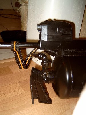

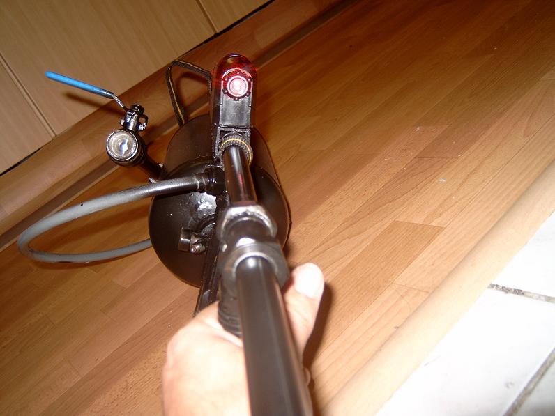

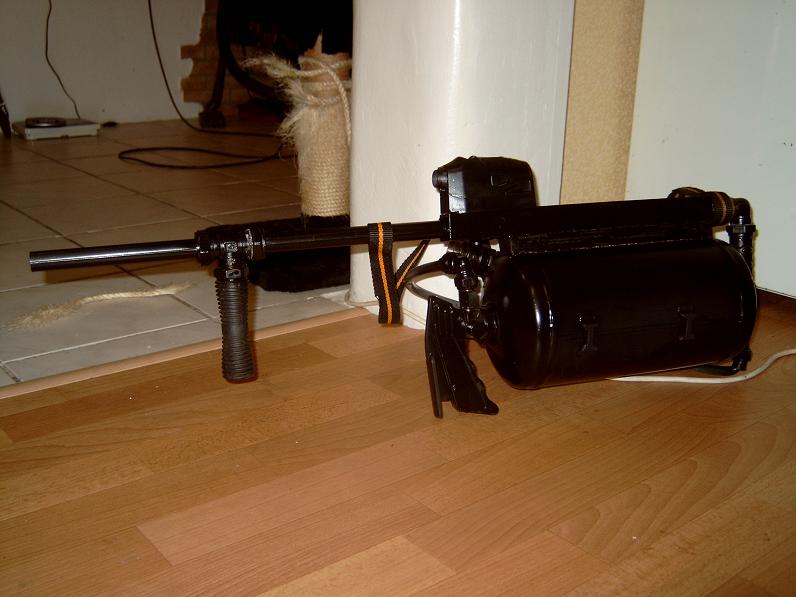

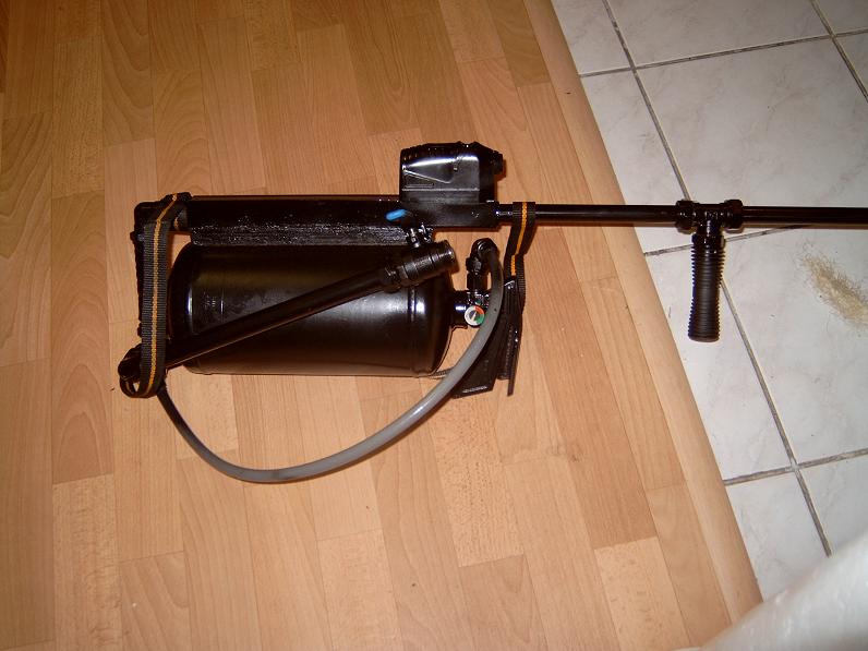

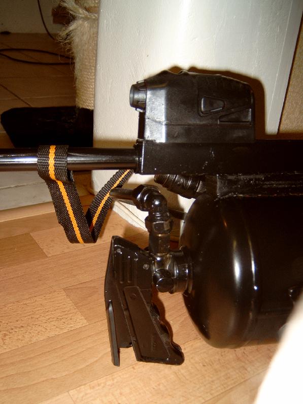

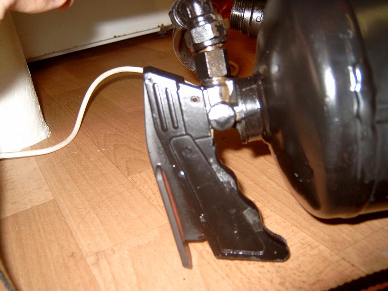

Gun name: Marble MG   by Brian the brain
Type: Pneumatic
Caliber: 16mm
Barrel lenght: Aprox 65 cm
Construction material: All metal
Max pressure: 16 bar
Reservoir : 4liter
Valve: Fire extinquisher valve ( high flow)
Power source: High pressure hand pump
Ammo: Marbles
Magazine capacity: 23 marbles ( configured like a bullpup)
R.O.F: Roughly 20 rpm
Sights: modified laser tool
It rips up drywall at 10 bar.My experience says it WILL rip up 1/2"plywood at 16 bar.The mag and rise tube restrict the marbles from piling up or passing each other.THis means I can load a slightly oversized marble as the last one to close off airflow when the gun is empty.So I waste no air when the mag is empty.

very nice design. i really like how you used a fire extinguisher valve as your trigger. thats something very few people do. im tempted to use a fire extinguisher on a friend of mine to use up the CO2 just to get to the valve, as well as the metal tank as a resevoir. what is your estimated range with this puppy? and also do you have any idea as to the speed of the marbels when they fly out of the barrel?

if you got this bigger marble stuck in the gun on purpose, how do u get it out?
						Wow thatd suck, i like this gun, mines is much simpler, i like the handle. If later on you have any ideas of what to do with a fire estinguisher i made a semi auto (easily upradable to full) golf ball shooter and a soda can shooter, FUN. Peace.

The last marble doesn,t really get stuck.It just blocks the barrel inlet when pressurised, and drops back if I release the trigger.If not I can always poke it out muzzle-loader style using a rod.
i have no clue on the distance.I ve only done testshots and I want to retrieve the marbles to re-use them.

Great job, I love the style of this cannon. You should add some sort of butt plate for looks and comfort.

The back "rise tube" has soft rubber padding.
I could do it for looks, but I'm happy with it as it is.Only thing left to do is a silencer.
