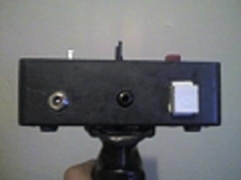

I finally finished my trigger box network cable and all. It all work's, had to take the battery's and all switches and safety's out of the stun gun the battery power is made possable true the trigger box. The thing is the battery for the trigger box isn't contained in the box, it is a 12 Volt battery from a ride on electric four wheeler that plug's in to the back of the box like a power cord for a laptop.
The little plug to plug the network cable in is a surface mount one so no loose wire's to get snagged, other than the wire for the battery and remote wire but at 25 foot away from the cannon there's nothing to worry about. Just wanted to let you all know it is done. There is a resistor between each LED so the LED's can work on 12 volts.
The wire between the cannon and remote is a Cat-5 Network cable 25 foot long, I was told it wouldn't work but I knew I could get it to work. Any Ideas to make the Remote trigger box completely wireless would be greatful.
This is an Update for my Remote Trigger box, it is complete, switches LED's, plug for network cable and plug for power. The trigger box has been tested and is 100% functional! :) I have the pics just need to upload them. If You have any Questions please don't heasitate to ask.
Switches and LED's. You Know what the red button is for LOL :)
Trigger Box Front.jpg (13.98 KiB) Viewed 5541 times
Were the Plugs go
Were the Plugs go
Trigger Box Back.jpg (10.05 KiB) Viewed 5541 times

you need to get a label maker and make the labels more official looking. Is it for a specific gun or is it going to be for a number of guns

um, usually for remote firing things the arm means that there is a circuit established, to make sure you didn't do something wrong
um, how do you plan on getting a circuit w/o a spark?
or have you done something different with the arm?

Yea, I know that I need a labler to make it look more official but I got to wait till payday. And the Remote will be able to be used on ANY combustion gun I make in the future. The only thing that I need to do is get another stun gun for any future guns.
sandman
The Main switch controls the power to both Arm and fan switches. The arm switch just controls the power to the fire button, so I don't accidently push the fire button. The fire button turns on the power to the stun gun exturnally. The stun gun is still on the cannon which makes the spark. The remote just controls the power for the fan and stun gun corded 25 feet away buy Cat-5 network cable. This is a concept from the way a Detonator for TNT is built. I still might get a key switch for the main switch to make it more authentic looking.

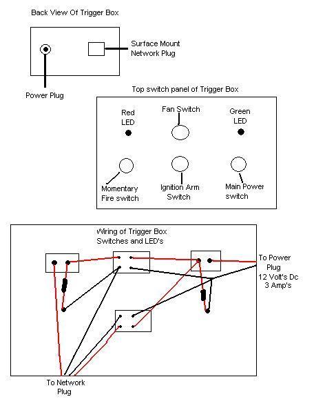

This is how it is wired up hope you can understand this I'm not good at making diagrams.
Wiring Diagram of My trigger box.

ok, yea makes since now
and i would get the key for the main like you said
