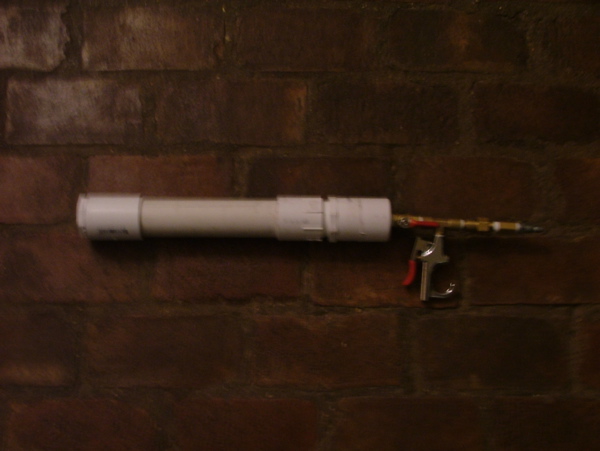

This started out as a diaphram cannon, but later on I decided to create a piston for it to see if it would perform any better. Now I have a gun that can be used as a diaphram or a piston gun using the benifits of both valves, and I believe I am the first to do this.
SPECS
chamber: 1.5" sch40 pvc
barrel: 0.5" sch40 pvc
valve: selectable; diaphram or piston
pilot valve: modded blowgun w/ ball valve safety
fill valve: screw-in schrader or a check valve attached to coupler nipple

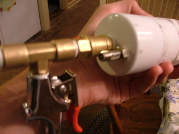

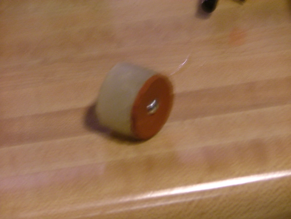

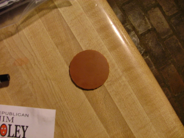

My diaphram is made of 1/8" sheet rubber, and it fits between a male adaptor and a female adaptor. My piston, which fits inside the male adapter, is made of hot glue and it has a neoprene sealing face. My diaphram works great, it shot a medium weight projectile about 100 ft upwards pointing the launcher straight up. The piston did work, It just didn't open fast enough to let a sufficient amount of air come out the barrel. This problem could easily be fixed, by using a larger pilot opposed to my smaller modded blowgun. This is my first gun with a completely homade valve, and I am very proud of it. I plan to be making a barrel sealing piston valve with 1.5" porting all housed in a 2" T, but it won't be started for a while.

I don't have a chrony, but in order, damage-wise, the piston was worst (shot through one side of a can), diaphragm was second, (shot through one side and split open the other side), and the combination shot through both sides and dented my shed.
nice. what did you get the rubber from and what did you cut it with? its a great looking gun you got.

I used these nice Fiskars scissors that are used to cut thicker materials, especially bushes and small branches.

I sprayed the inside of the pipe my piston was in with cooking spray and squirted the hot glue in. It is quite simple...

Another method: cooking oil works well, but if you having trouble with it you can also use greased up baking paper around the inside of the pipe, this increases flow quite nicely too.
Did you melt the glue through the gun or microwave it or what though?

I melted it through the glue gun.
