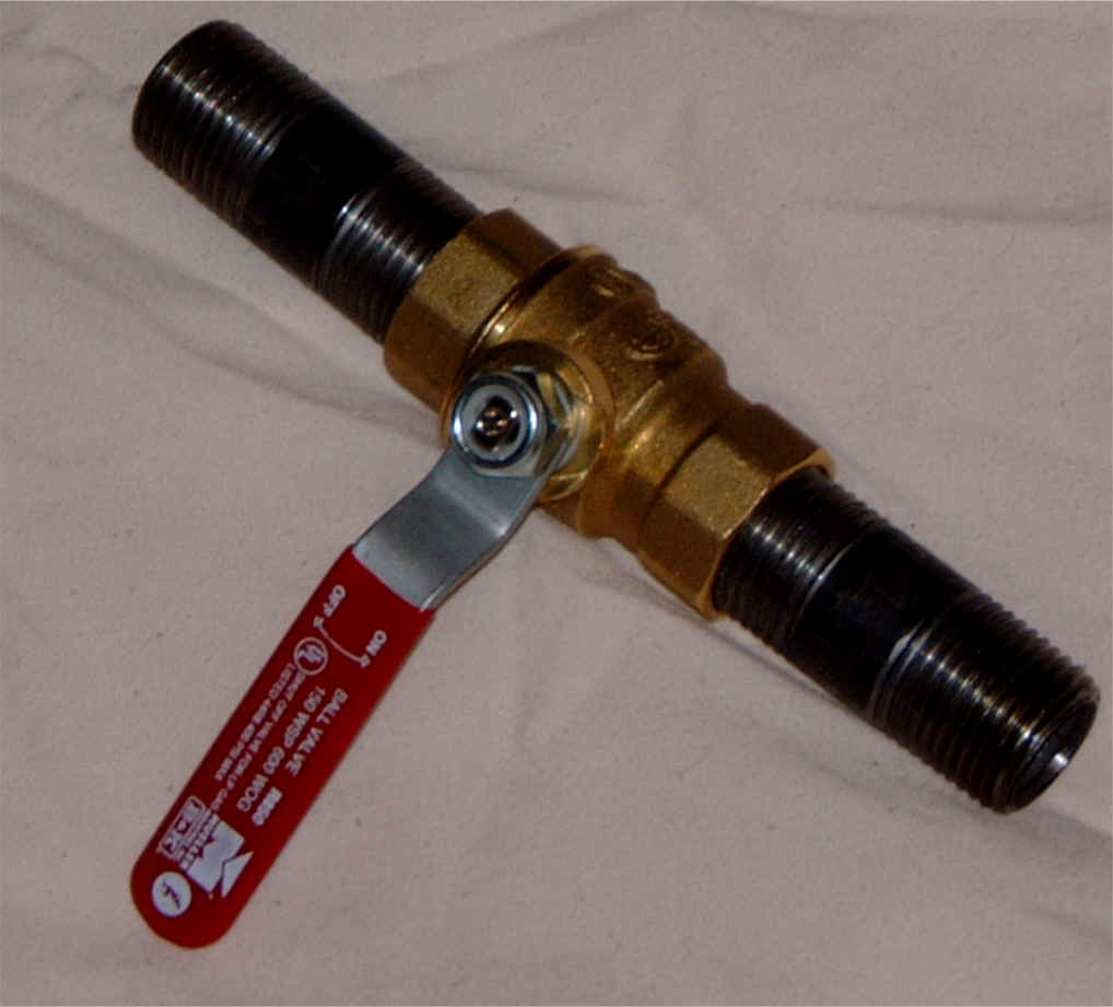

ball valve with 2 niples (hahaha)

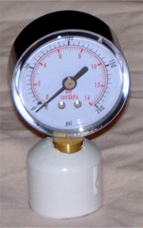

3/4 endcap with gauge

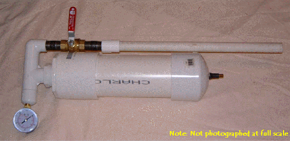

heres what it should look like all put together. the three inch pipe section is 1ft long

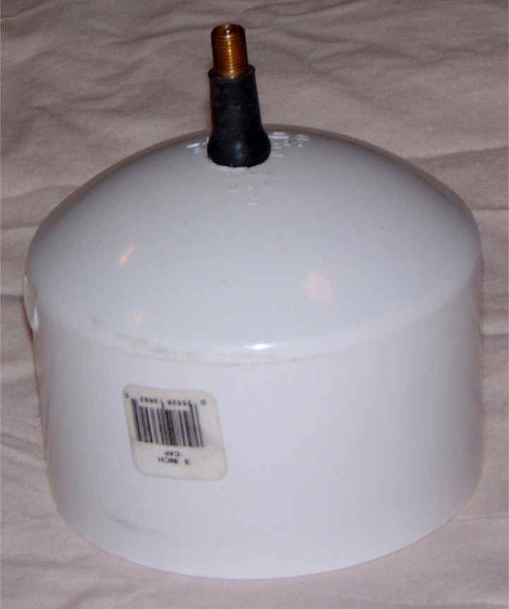

the endcap, with shrader. im sure you can figure it out.

But I think you should use a Male Spigot to Female NPT fitting, instead of the drilled end cap for the gauge.
Like this one:
I would also recommend using Flickr for your image hosting, it will give you more control over the size and arrangement of your pictures.

Yea as i said, my camera isnt working a.t.m. so these pics are off another website. I too strongly recomend using a Male Spigot to Female NPT fitting. It is much safer and safety is always a requirement when playing with air and PVC.
