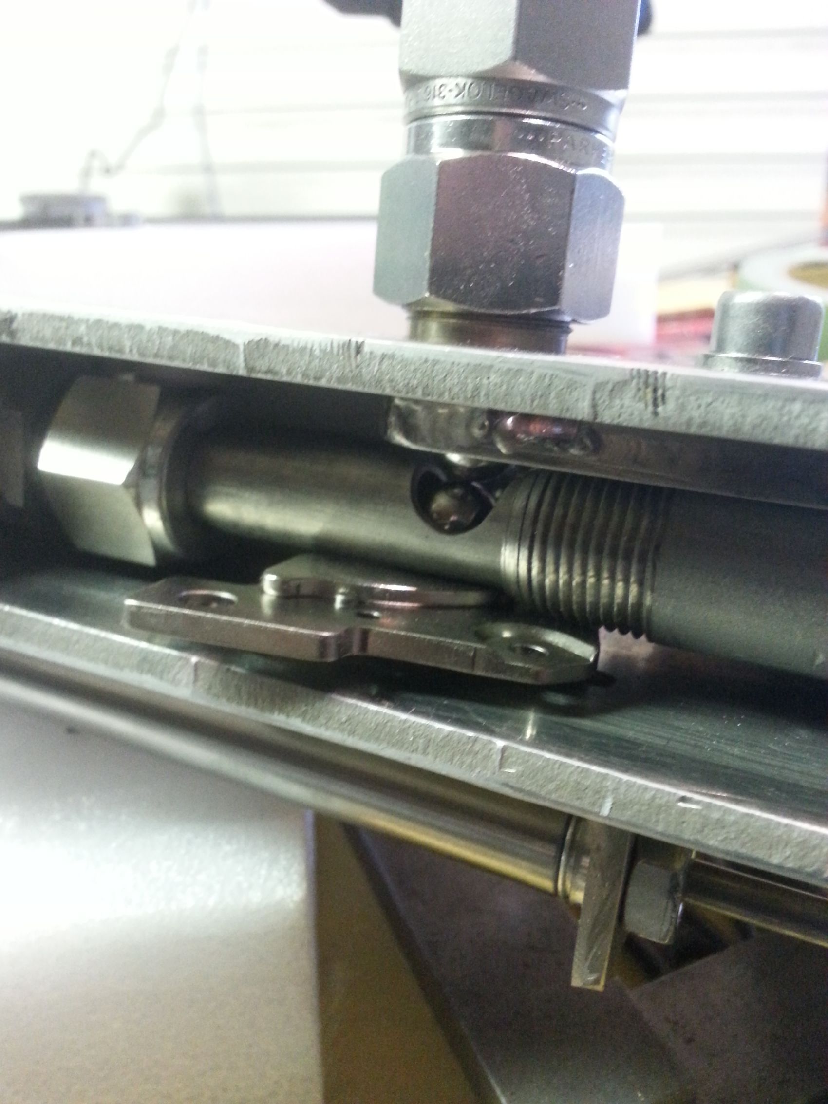

Time to call it finished, compressed air (135 psi) powered, 10mm ball bearing ammo, semi automatic, magazine holds 10 + 1 in ready. The stock is the chamber (1 1/2" pvc), barrel is 1/2" OD seamless stainless tubing (10.2mm ID) 700mm long. Main valve (3/8) is controlled by pilot valve (1/8) pulse, this pulse can be adjusted by the air restrictor to give different times/power. Valves are pilot air actuated 5/2 spring return, but had to add external pilot air to main valve as I was feeding it through an exhaust port not the P port.
Mostly made from scrap aluminium/stainless/pvc, about 200hrs+ work, hand tools and a drill press only, couple of the fittings were Tig welded, but only because I didn't want to buy anything for it. Front grip is a grinder handle
It is 1070mm/42" overall length, 6.4kg/14lbs in weight.

Adding some construction pictures cause I'm adding this link to Youtube. Also adding a video

Finished the removable magazine
It hooks onto a pin at the front then pivots in and locks
New charge handle and shut off for loading cylinder to make it single shot
Now it's much slimmer with the magazine off
And I can check to see if it is loaded or not
