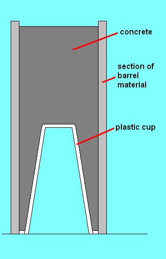

cone shaped dixie cups with a washer in the base, then fasten it to you mold and fill with something else other than quikrete. it is too abrasive.
Having a pointed nosecone won't have them flying any straighter, to achieve this you need a hollow tail - here's a suggestion on how to achieve it.

Go jsr, that us exactly what i was thinking. Now we could make a pointed tip made out of epoxy. w00t

To make a pointed tip all you have to do is add another cup to the top of the pipe with a hole on top to pour the concrete through, why waste precious epoxy
