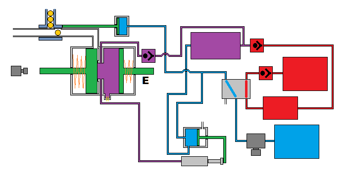

I thought I would make a post on behalf of hectmarr to clarify the operation of his semi-automatic hybrid.
Here is a schematic of the system:
Here is the cycle animated, springs are omitted for clarity:
Here are some step by step details of the cycle:
The system is shown here ready to fire. The fuel/air mixture is retained by a spring, while the pressure from the compressed air reservoir keeps the chamber exhaust valve closed as well as the ammunition feed locked.
Pulling the trigger ignites the fuel/air mixture and the overpressure pushes the firing chamber piston forward, allowing the gasses to escape and fire the projectile in the process. At the end of this travel, this piston pushes a switch that temporarily actives the 5/2 solenoid.
This shuts off the fuel (butane) feed while also venting the compressed air line. Return springs push the ammunition feed to the open position allowing a new projectile to load, as well as opening the chamber exhaust valve to vent any burned gasses. Once the solenoid is deactivated (through the operation of a capacitor relay) the compressed air feed is restored allowing the system to reset ready for another shot.

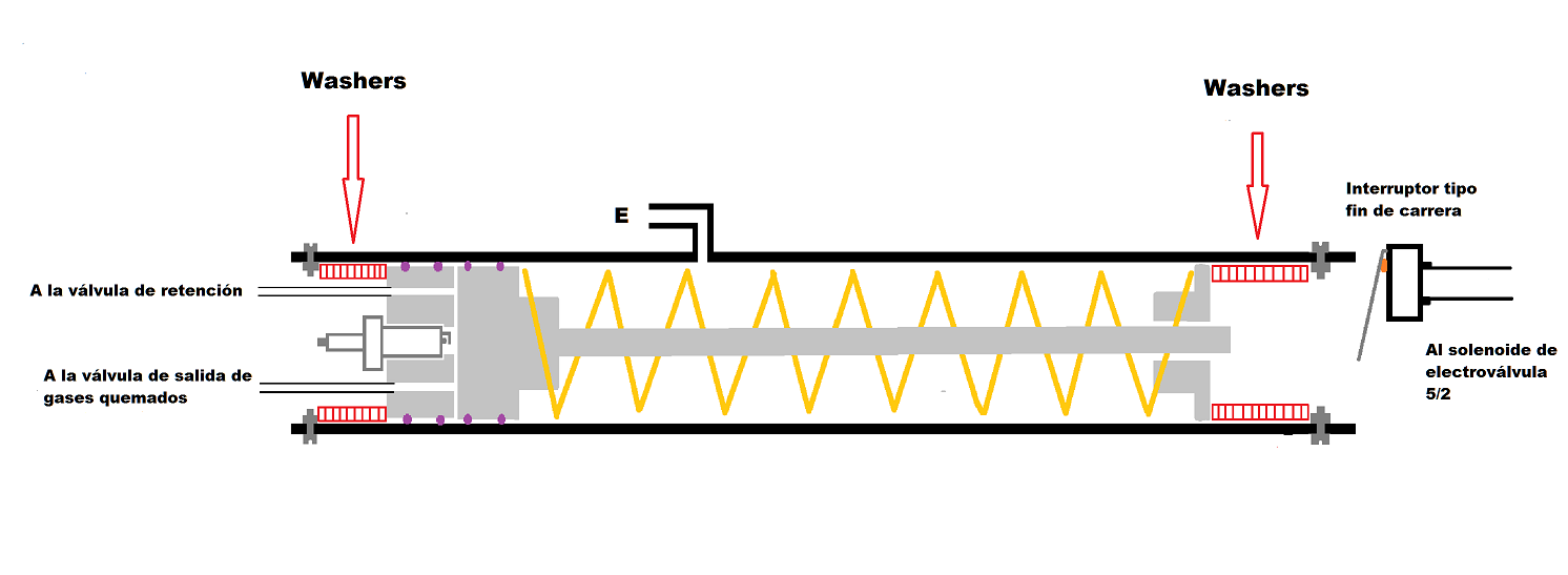

I have tried to regulate the opening time of the exhaust port so that it opens before or after. This is achieved by increasing or decreasing the washers, (in red in the diagram), which ultimately moves the piston closer to the outlet orifice. There are important variations in the energy of the shot. The best performances are achieved when it is two or three millimeters, that is, when it does not take long to open. The mass of the piston and spring have to do with this question.
The amount of washers is always the same, so as not to alter the force that the spring makes, they are only taken from one side and put on the other, and the other way.
On the other hand, the ammunition in the firing barrel, which is tight and seals well, retains the gases a little more. Shooting without the ammunition, only produces a soft "puf". When I insert the ammunition, it makes a strong explosion, and I think it is for this reason.
I'm going to make a short video this afternoon so they can hear the difference.
I conclude that to achieve the normal pressure peak in a hybrid, one must consider the combustion chamber, and the firing barrel seal, as unit. Only this way works. The opening time depends on the mass of the piston and the spring, the distance from the piston to the exhaust port. The further away, the later it will open. I have played with this.
It is different with the rupture discs, which produce the peak of explosion pressure, with the combustion chamber alone.

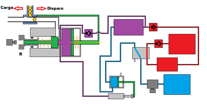

Here is a configuration I had designed for a pneumatic but I'm sure it would work for the hybrid too:
The green bolt could either work as a blowback mechanism powered by the shot or moved independently by pneumatic control as in your current prototype.

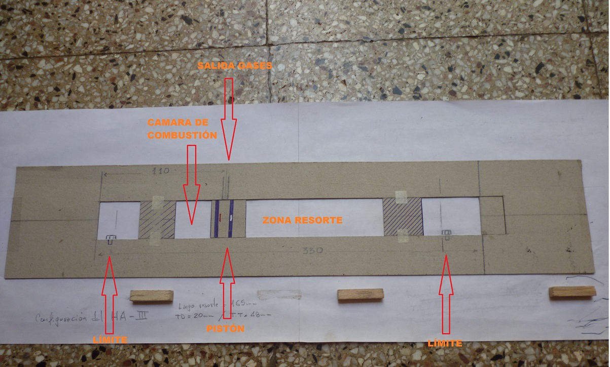

I have built a regulation template, (photo), and based on the program data to calculate the dimensions of the spring, I configure it to perform as best as possible.

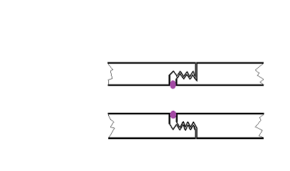

I'm going to try to include an o'ring in the firing barrel, to retain a little more or a little less the ammunition. I've thought of something simple like the diagram. With the adjustment of the thread, I think to regulate the retention because the o'ring closes in the center when it is compressed. I imagine that it will improve in terms of regulation and strength. :roll:
In a world of digital calculations I find this analog unit very charming :)
I can confirm that this solution works well for spherical projectiles. Here it is used for a 3mm BB machinegun:
In this case it was a failure, because the second BB blocks the o-ring while the first one is still in the barrel and much hilarity ensues :roll: but you will not have this problem in your system.
I have used it for hybrid cartridges too during my long and to date still unfinished saga :roll:

The system could be simplified, using the auxiliary piston rod to move the ammunition loading system slider. Without the mechanical actuator, the air consumption will be optimized, (which is the basic reason why I have chosen to use springs and not a pilot air chamber).
The ignition can be included in the same auxiliary piston.
The back cover of the combustion chamber can have a regulator to vary the compression of the spring, "R" in the diagram, and play with this to achieve that there will be at different pressures, to optimize this theme.
